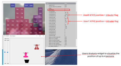

To visualize the (X, Y, Z) position of each person in front of the sensor, you can use the SPD EVK GUI and use the Users Analysis widget as shown below...

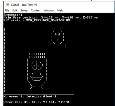

If you prefer using your favorite Serial Com emulator like TeraTerm, you'll get this kind of outputs showing the same kind of information...
