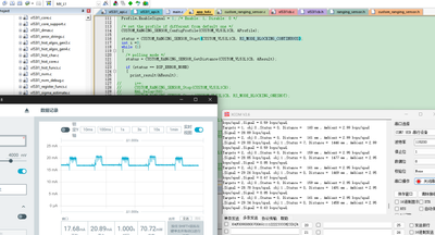

This image shows the current curve during ranging. The configuration is a 50ms timing budget, a 50ms inter-measurement period, and long-range mode.
By tracing the function calls, I found that VL53L1_ClearInterruptAndStartMeasurement is already called within the VL53L1CB_GetDistance function. The ToF driver and the demo program were generated using CubeMX software.
As a side note, there is a significant difference in power consumption between different library versions.
2025-08-31 8:57 AM
The CB code had an issue and it was decided to fix the issue with a patch to the code on the sensor. But that means that one has to keep the sensor alive enough to not lose the memory. And that is why the histogram parts do not go into their lowest power setting.
However, that patch is not used in the non-histogram parts. And it should be a lot lower than the 17ma shown in your plot.
And especially the ULP driver should get down to zero.
Could it be that you are measuring something in addition to the power used by the sensor? When I was doing this, I inadvertently was measuring some pull-up voltage. (I blame my software background.)
but if you power consumption is too high, ensure the interrupt is clear, and the I2C lines are both high. It's really all I can think of.
