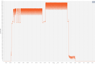

Hello ST team, as mentioned in the title, I found that the power consumption when using the ULP library to drive TOF L1 is inconsistent with the manual. I'm using the official evaluation board vl53l1-satel. Below is my test code and power consumption data. In my code, you'll see both ULD and ULP libraries, but I'm actually only using the ULP library; the ULD library is commented out.

The CB code had an issue and it was decided to fix the issue with a patch to the code on the sensor. But that means that one has to keep the sensor alive enough to not lose the memory. And that is why the histogram parts do not go into their lowest power setting.
However, that patch is not used in the non-histogram parts. And it should be a lot lower than the 17ma shown in your plot.
And especially the ULP driver should get down to zero.
Could it be that you are measuring something in addition to the power used by the sensor? When I was doing this, I inadvertently was measuring some pull-up voltage. (I blame my software background.)
but if you power consumption is too high, ensure the interrupt is clear, and the I2C lines are both high. It's really all I can think of.

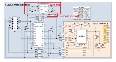

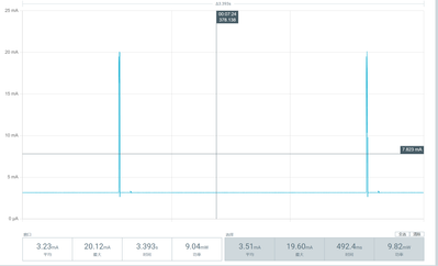

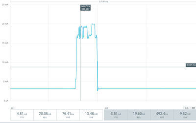

My main confusion is why there are still several mA of power consumption when the TOF rangefinder completes measurement and enters software standby mode. My MCU and TOF have separate, independent power supplies. Also, when using the ULD library, the power consumption after ranging completion and entering software standby is only a few μA, which is consistent with the manual. Therefore, I don't think it's an issue with my hardware connections.When I pull XShut low, it consumes about 400μA of current at 2.8V supply (all my power to the TOF is 2.8V)。I also made some modifications to the circuit, removing the voltage regulator chip and shorting R21 to get closer to the device's power consumption, but I didn't remove the level shifting chip because when I removed this chip, the TOF stopped working for some reason.

I was completely confused until you mentioned 'level shifter chip'. Those things are the root of all evil. I know we need them sometimes, but they have caused me so much pain in the past that I've learned to hate them.
Do you really need it?
Certainly, if you are going a long distance, they help. Of if your MCU needs the 5V I2C, you are kind of stuck.
But the sensors I2C can handle I2C up to 3.6.
But can we try something:
(The VL53L1, L3, and L4s all have the same I2C interface.)
In the VL53L1 Sensor, there was a setting a bit of code in VL53L1_DataInit().
#ifdef USE_I2C_2V8
Status = VL53L1_RdByte(Dev, VL53L1_PAD_I2C_HV__EXTSUP_CONFIG, &i);
if (Status == VL53L1_ERROR_NONE) {
i = (i & 0xfe) | 0x01;
Status = VL53L1_WrByte(Dev, VL53L1_PAD_I2C_HV__EXTSUP_CONFIG,
i);
#endif
And you need:
#define VL53L1_PAD_I2C_HV__EXTSUP_CONFIG 0x002E
This changes the expected mid-point of the I2C - and thus the point it clocks the bit. As the mid-point between 0 and 3v3, is not that much different than the mid point of between 0 and 2v8, one can write the register. But this makes the I2C more reliable if using the 2v8 - which you use.
And it might help to get rid of the level translator - saving you a bit of money.
And I'm hoping it will save you that power drain as well.

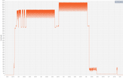

This took me forever, but I have an idea.
I ranged and read out the data, printing it. I then cleared the interrupt.
On my power plot you can see the high-power ranging, then the lower-power I2C access. Then (after the print time) you can see the I2C command to clear the interrupt. Then the chip goes into lowest power.
I then ran the SAME code, but moving the clearing of the interrupt BEFORE I read out the I2C data.
Note how the power consumption goes nearly to zero just after the I2C reads.
So I'm suggesting you clear the interrupt before you do anything else.
My code looks like this:
void get_data_by_interrupt(uint16_t dev){
loop=0;
do
__WFI(); // Wait for interrupt
if(IntCount !=0 ){
IntCount=0;
VL53L4CD_ClearInterrupt(dev);
/* Read measured distance. RangeStatus = 0 means valid data */
VL53L4CD_GetResult(dev, &results);
printf("%4u Status= %2u, Distance= %5u mm, Signal= %6u, %6u kcps/spad, Spads= %3u Sigma= %2u\n",
loop,
results.range_status,
results.distance_mm,
results.signal_rate_kcps,
results.signal_per_spad_kcps,
results.number_of_spad,
results.sigma_mm);
loop++;
}while(1);
The important bit being the ClearInterrupt() as soon as possible after detecting it.
Hopefully that works. My theory is the sensor will not go into lowest power until the interrupt is cleared.
BTW: I used the SATELLITE VL53L4CD sensor and the X-Nucleo-LPM01A with the STM32CubeMonitorPower software to do the analysis.
