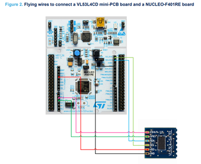

In AppNote AN6049 on the ST web site there is connection diagram. (It's for the VL53L4, but the parts are interchangeable.
I'd use this diagram. And monitor the power consumption as you ground the XShut pin.

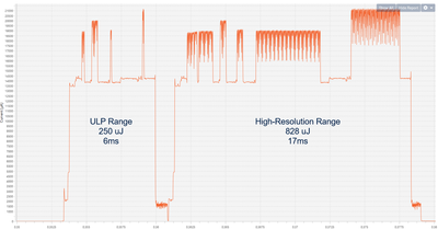

IN my testing of the Low power with accuracy, I had a plot of the power consumption that looked like this"
That first ULP range was the low power consumption. When the code determined there was a target, it took a High power range to get an accurate range. the space between them is the I2C transactions. And the initial bit and the final level are low indeed.
Certainly it's in the micro-amp range, not milliwatts.
If you can show me a plot like this, perhaps I can find something.
-john

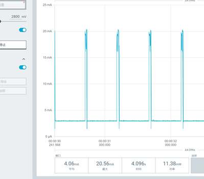

Hello John, Figure 1 shows the current curve when I use the ULP library with a 2.8V power supply. Those current peaks represent the current consumed when the chip is measuring distance, while the current valleys show the current when the chip has completed distance measurement and entered software standby mode. My main question is, why is the current in software standby mode so high after distance measurement is complete? I've removed the voltage regulator chip and used independent power supply, but I haven't removed the level shifter chip (I don't think the level shifter chip's power consumption would be this high, and when I use the ULD library, the software standby current matches the manual, so I believe the abnormal standby power consumption with the ULP library is unrelated to the level shifter chip). Figure 2 shows my configuration code using the ULP library.
