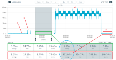

I'm using the VL53L4CD with the STM32WL55JC1, The following is the Power Profile of the cycle:
1- XSHUT GPIO is normally pulled low.
2- XSHUT Pulled up + delay ( sensor wakes up).
3- VL53L4CD Initiliazation.
4- Measurements (20 Samples).
5- XSHUT Pulled Low again.
Just after the initializing of the VL53L4CD, the current consumption was 4.45uA, then after HW-Standby, I can't get less than 332uA!?
Why this high amount of consumption even if the XSHUT is Pulled Low?

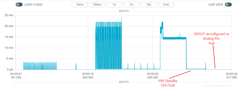

2023-12-13 6:28 AM
Ok, i found a solution, turning the XSHUT-Pin into Analog after HW-Standby Solved the issue:

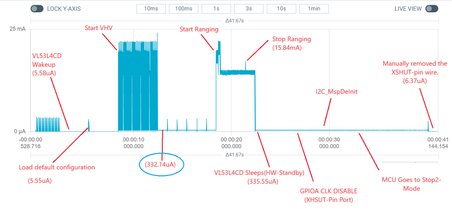

As I wanted to know which line of code changed the consumption of the HW-Standby from 4.45uA(Original Post) to around 330uA, I ran the following:
- VL53L4CD_ULD_V2.1.1 Driver used.
- VDD: 3.3V.
- XSHUT: Normally High(No Internal Pullup).
- XSHUT-GPIO & I2C Clocks will be Disabled after the Sensor goes to HW-Standby.
I put a few seconds of delay between every line of code that modifies the sensor's registers in the initialization function and draw the power profile it as follows:
Observation 1: The high consumption that starts to happen during HW-Standby starts after the "Start VHV" Line.
Observation 2: Stop Ranging Command does not affect the Power Consumption!!
Observation 3: Removing XSHUT-Pin Manually seems to stop some leakage current happening there(I'm thinking of how to simulate the same behavior in SW).
What do you think?

2023-12-13 6:28 AM
2023-12-13 7:07 AM
Thank you to share how you did.:grinning_face:

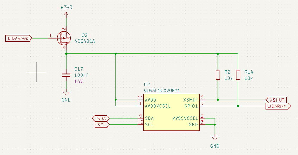

2024-08-06 7:20 AM
How did you connect the rest of the I/O to the Lidar? I have got a similar issue where my custom pcb consumes 100 μA more when using the lidar.
I do not use the LIDARint pin, Xshut does not really seem to work with my application and is pulled down by the mcu.
after each measurement I turn my mosfet off, but there seems to be 1.8V leaking in somewhere.
2025-08-31 3:12 AM
The leak is due to the 10K pull-up at GPIO1. If interrupt is not used, remove the pull-up should solve the leak.
Note: 3.3V/10K = 330uA
