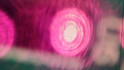

WARNING - Do NOT view that light through any kind of magnification. When you concentrate laser light it becomes dangerous. You cannot see it and a concentrated Laser light will damage your eyes.
Now you have video evidence that you have very little output signal, and that the sensor is actually turned on and operating.
Now you have to figure out why the coverglass of the 'good' sensor is letting the light through and the coverglass of the 'bad' sensor is not.
I have to believe that these cover glasses are not the same.
- john
2024-01-26 7:50 AM
With 1/10 of the signal coming back, you do get erratic values. But as all of your distances are short, you are getting an amazing contribution from your coverglass.
Just based on the fact that your bad measurements are long I'm guessing your coverglass is spreading the light far and wide, hitting the wall behind your target and bouncing back.
Take the glass off and look at it through a microscope. My guess it will look like creators of the moon. Or it's all scratched.
- john

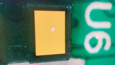

To demonstrate this I removed the cover glasses and tested again with the microscope.
Bad sensor :
Good Sensor :
There are things that will affect how bright the sensor appears such as angle and ambient light. I've kept those as constant as possible. No matter what way I look at it (literally) the bad sensors have little to no output compared to the good sensors.
