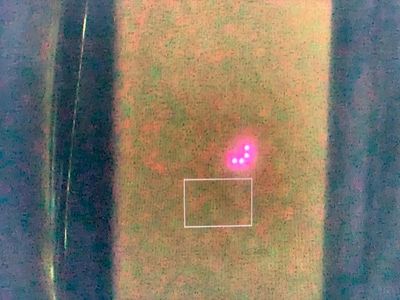

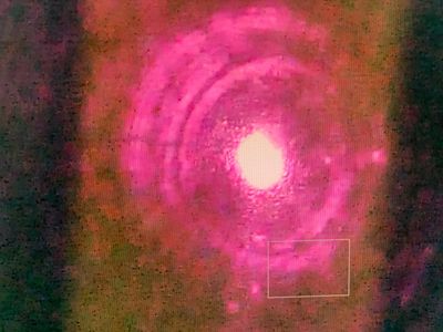

Use a camera to verify (but NOT an Iphone - the IR filter is too good.) Check the relative brightness of the laser flash.
I found something interesting here, on the good sensors I can clearly see the laser flash when using an Android camera (you are correct about the iPhone filter). However on the bad sensors I can't see anything at all on the camera.
Under the digital microscope it's even easier to see the difference.
What does this tell us?
Faulty sensor hardware? (I've triple checked my supply rails and connections)
Any firmware settings I can modify?
Good Sensor
Bad Sensor
