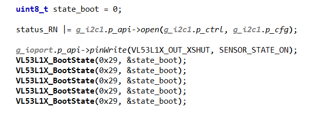

I have done all of the above John said except ranging. This is my code (my code is located at the beginning of the FIRST thread of the program, so It is the first thing to be executed after the internal MCU initializations).

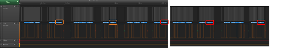

These are the values of the five calls to "VL53L1X_BootState()" :
Write: 52 00 e5
Read: 53 02
Write: 52 00 e5
Read: 53 02
Write: 52 00 e5
Read: 53 03
Write: 52 00 e5
Read: 53 03
Write: 52 00 e5
Read: 53 03

}After waking up the sensor I check the first bit ([0] firmware_bootup) for a while, looking for value 1. There are two possible situations:
1) There's no delay between XSHUT=ON and VL53L1X_BootState. The secuence is:
Write: 52 00 e5
Read: 53 02 (0000 0010)
Write: 52 00 e5
Write: 52 00 e5
Read: 53 03 (0000 0011) --> Sensor booted
Write: 52 00 e5
Read: 53 03 (0000 0011)--> Sensor booted
Write: 52 00 e5
2) There's a delay of a few milliseconds between XSHUT=ON and VL53L1X_BootState(). The sensor has enough time to wake up, so the first time I ask for the boot state the sensor answers it's already booted:
Write: 52 00 e5
With respect the second bit ([1] firmware_first_range), it always returns the value 1, regardless of whether a measurement has already been made or not. Regardless of that, the sensor seems to be working.

2024-11-06 7:40 AM
Note that in case of receiving 0x02 the target does not acknowledge index 0xE5 and thus we cannot be absolutely sure that the 0x02 we received is related to the register being read.
