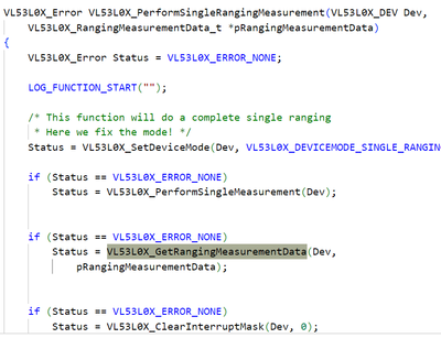

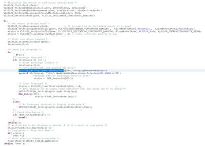

I only see a single measurement with VL53L0X_GetRangingMeasurementData(),and continue mode not find
