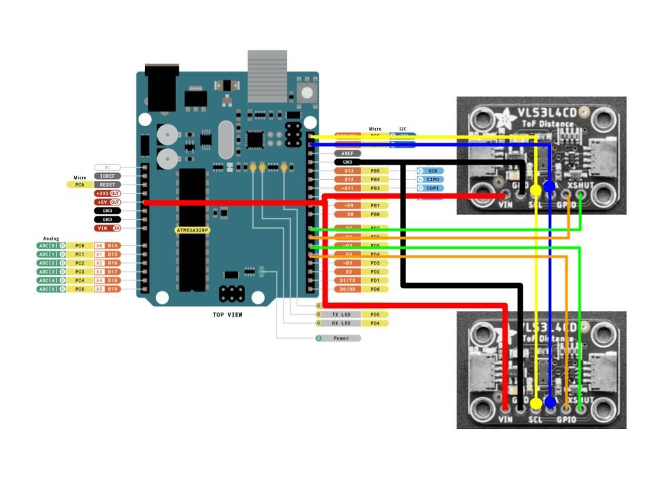

Wire diagram for reference:
Untitled-drawing
