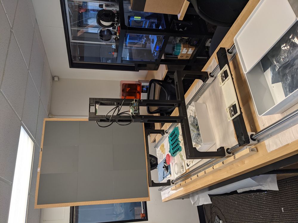

Our other problem is xtalk calibration procedure itself. With our coverglass, we get "near ideal" ranging performance out to 100 cm, and we don't need anything further than that... so this does not call for xtalk calibration. Any time we add a comp rate, it worsens performance. However, the problem is that when a smudge is placed on the coverglass, all bets are off; performance nosedives.
How should we determine what Xtalk comp rate to use for RIT when, actually, we normally are better off without enabling a comp rate in the first place?
A related issue: even when we did tested older versions of our applications which were known to be "less than ideal", the comp rate calculated by the PerformXtalkCalibration( ) function was inappropriate. We built a testbed to recreate the calibration procedure detailed in the manual, but the comp rates that the API function gives us are generally 3 to 5 times stronger than necessary. That seems like a problem which would also affect trying to get an Xtalk comp rate to use for RIT.
