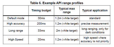

Hi ST,
I am currently actively debugging and working with the sensor and it shows correct measurement data when i set the profile to 'Long range' example (settings from the 'um2039' User manual).
however the sensor response for RangeDMaxMilliMeter: always show a value around 1200 which should be around 2000, is there another settings which i need to do before the profile is actively set to long range?
Measurement data is now also correctly measured until about 1200mm but higher results in invalid measurements.

Dmax is the most mis-understood range result.
But say you had a lot of ambient light - and saw basically nothing. Dmax says "in these light conditions, I could only 'see' this far." Which means if you DMAX was 1.2 meters and you had no target the sensor could guarentee that there was nothing up to 1.2 meters.
If you have a target DMAX is kind of meaningless.
The intent was for a autofocus application. With no data to go on, where whould you start the focus operation.
Just start at DMAX and see if the camera can use it's algo to focus. But you don't have to search for focus points below DMAX.
-john

HI John,
Thank you for your reply, i was under the impression that DMAX was the max amount of distance the sensor could detect with the given settings. (e.g. for long range profile this would then be higher).
Then ill change the softwares implementation of DMAX.
furthermore, our problem turned out to be a HW issue with our cover glass, without it and the above code/settings the sensor can measure beyond the 1,2m.
I was expecting DMAX to show a value of about 2000 so that threw me off in searching the problem.
