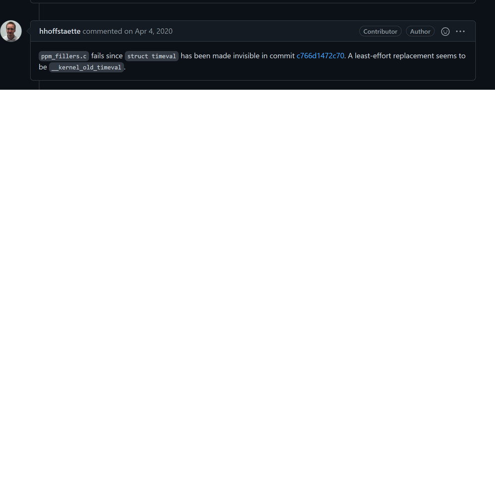

Seems there is a known problem compiling struct timeval with 5.x kernels:
https://github.com/draios/sysdig/issues/1609
I'm going to investigate what to do about it. I have not run across this before.
