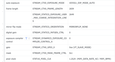

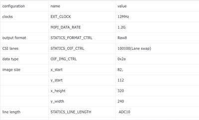

could you share a bit more information about Hardware and Software :

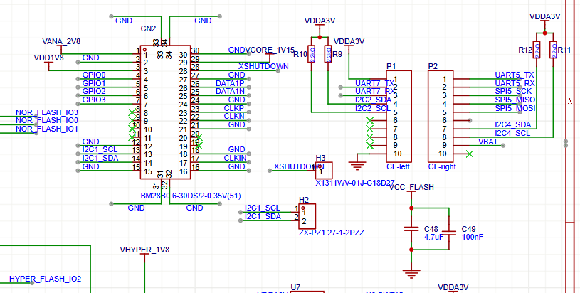

-Hardware: could you provide clock information and power domain or schematics
-Software : could you share sensor configuration you use.
Thanks in advance

It looks like you have GPIO0 set to VT_SLAVE_MODE but you don't actually toggle GPIO0 to initiate the start of each frame. If I understand UM3224(How to integrate and configure the VD55G1 sensor) correctly, setting GPIO0 to this value uses the FRAME LENGTH parameter as a "maximum frame rate" and it instead waits for a pulse on GPIO0 to begin each frame. If you never toggle GPIO0 (PG15 on your schematic) then it will never send out a frame.
2025-07-23 7:09 AM
Thank you for your reply very much.
I tried to set GPIO0 to output mode, but there is still no image data whether it is pulled low or high, and the stream_fsm of the camera is in the dark task.
