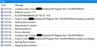

To reiterate my process, I plugged in the sensor, I loaded the software, I loaded the script, I tried to capture frames (and failed to), I rebooted the sensor from the software, I reloaded the same script, and I tried to capture frames (and still failed to).  Here is what the output of the log looks like:

What you are doing seems to be correct. Could you please clarify what you mean by “the following script will cause the SW to fail to read a frame sequence”? Are you seeing an error message? It would help us better understand the issue.
