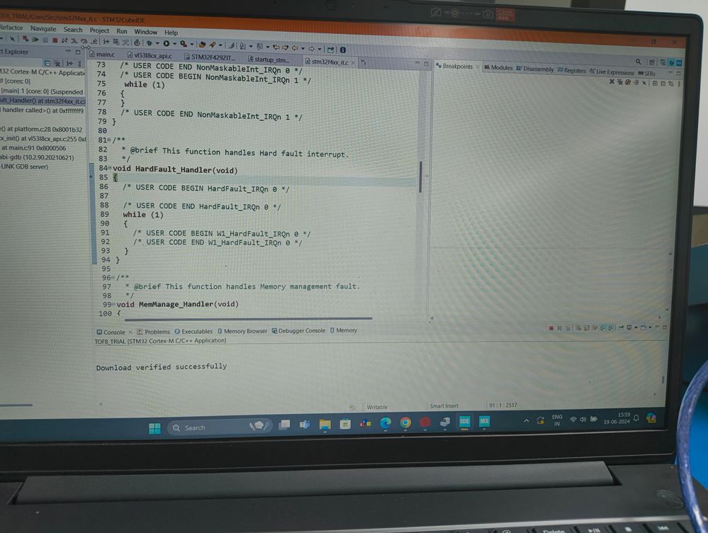

I am working with a vl53l8cx and following the instructions exactly to initialize the sensor but it always generates a hard fault error. I tried debugging , the hard fault is generated once the function Wrbyte is being called and it writes to the address 0x0777. As no register map probably exist I am stuck with this . Need Help

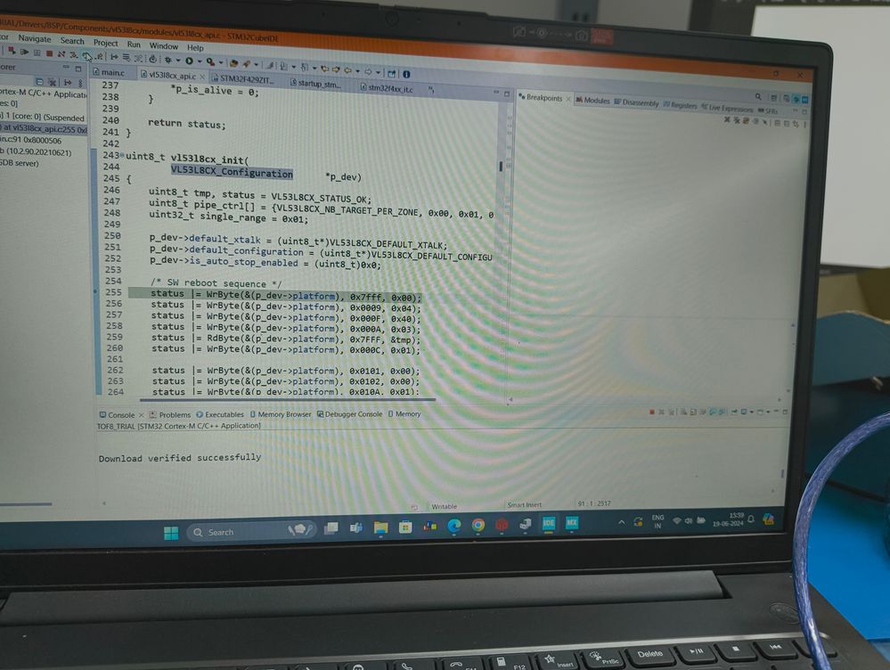

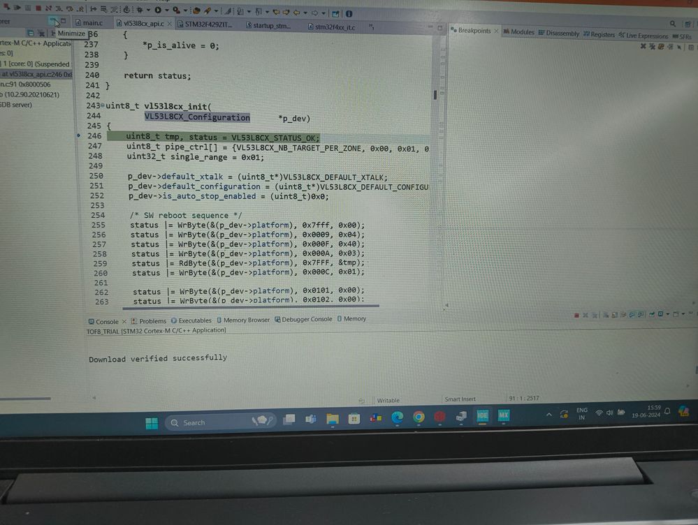

I am not really sure why I am unable to get it done . As it can be seen in the attached images . as soon as I try to intialize TOF by using the function vl53l8cx_init(); function a hard fault error is generated . as soon as the first command is used to write on register 0x7fff. the hardfault is generated. Kindly share if there is a document or a tutorial to use this sensor with either stm32wb series or stm32f429zit

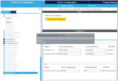

Thank you for your response . You are right I missed the frequency part but I have corrected it now . I am getting a warning in MX cube .
Kindly guide me how I can remove this warning and get things done.

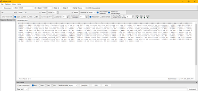

I tried using vl53l5cx with stm32f407G and followed the document UM2974 . The initialization failed again with this output on HTERM
What should I do to get it started?

That yellow warning is the key. Something is still not installed right. And unfortunately, I don't know what is wrong.
My experience says that until all the warnings go away, the CubeMX software will not run.
Your error message is telling you that the MCU cannot connect with the sensor. It's guessing that you are not trying to connect with the main sensor, but you are.
One of your i2C lines, your interrupt line or the reset pins are not fully configured in your project.
