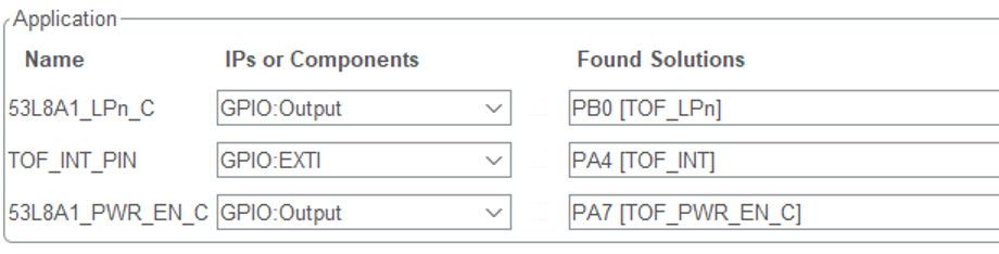

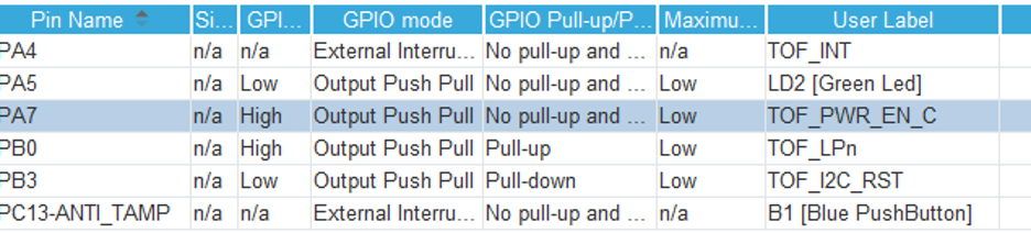

2024-06-24 6:40 AM
I can confirm that it is a pin assignment issue - at least in my case.
It wasn't the I2C but, instead, some of the control pins.
I'm using a 57L8A1 board plugged into a NUCLEO- F401RE board.
I followed the directions in UM3108 to generate the code for the SimpleRanging example and got the same error
VL53L8A1_RANGING_SENSOR_Init failed
Check you're using ONLY the center device soldered on the shield, NO satellite shall be connected !I realized that the directions in UM3108 apply to the 57L7A1 which has different pin assignments than the 57L8A1. After comparing the schematics, I figured out what needed to be changed to make the code work with the 53L8. I've highlighted the ones that differ in red:
| Function | GPIO for 53L7 | GPIO for 53L8 |
| I2C1_SCL | PB8 | PB8 |
| I2C1_SDA | PB9 | PB9 |
| LPn | PB4 | PB0 |
| TOF_INT | PA4 | PA4 |
| PWR_EN | PB0 | PA7 |
| I2C_RESET | PB3 | not needed |
I used the above info to modify what I did on UM3108 pages 16+.
In the end, the GPIO assignments looked like this:
corresponding to page 20 fig 28 of UM3108:
and page 23 fig 34:
Once I made these changes and re-compiled, the SimpleRanging app worked fine.
