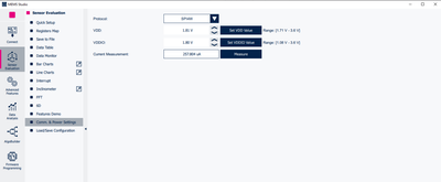

Hi @ola ,
You can change the communication protocol in the Comm. & Power Settings tool window:

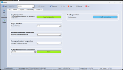

Hi Federica,
Thank you for your reply. Unfortunately I can see the page that you are showing on my version see below.
Regards
Ola

Correction:
Unfortunately I can not see the page that you are showing on my version of Unico-GUI.
Regards
Ola

Hi Federica,
Looking at your image again. I noticed that you were using MEMS-Studio which is meant to have replaced the old Unico-GUI application that I was using.
I have downloaded the MEMS-Studio and I can now read the I2C bus correctly. Thank you.
