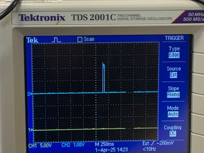

2025-04-01 1:14 AM - edited 2025-04-01 1:15 AM
Hi John, thanks for your reply.
I've tried hooking the sensor up to an oscilloscope and have attached the output I get from the GPIO 1 pin. I think you are correct with the fact that the interrupt is never cleared however I am unsure of how to fix this.
I've attempted to verify my write commands and can see that for 0x86 and 0x87 for stopping and clearing the interrupt, I am reading 0's from the registers after writing to them instead of 1 and 80 respectively again shown in an image below. My write command only throws errors for these registers and only for this not when writing to tell the sensor to start and I am unsure why.
Any further assistance would be much appreciated and apologies for the strange reply times as I am on Uk time.

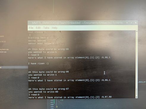

2025-04-03 2:33 PM - edited 2025-04-03 2:34 PM
Thanks for your reply. I wanted to clarify what the debugger is?
Just some further clarification on the exact issue as this does not appear to have worked for me. I am currently working on translating the driver code into C++ to use gpiod for the a callback-based system. I have succeeded in translated over all of the read and write functions and I am working on copying over the SensorInit() function. As I have mentioned before, the interrupt does not appear to be cleared by my write command, although I have verified that my write command works for writing a single byte to any of the other uint16_t registers except for that one.
You mentioned previously that the issue may be that the interrupt is too fast. However, I have verified further on the oscilloscope, that even viewing it down to the nanosecond scale there was no rise after the initial interrupt, which causes it to fall. I will attach an image for your reference.
I have also attached the relevant code snippet where I am writing to the registers. The code appears to fail at line 62, following which "I have risen" is printed.
Thank you for any advice that you can offer, and apologies if anything is unclear.

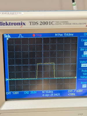

2025-04-04 11:14 AM
Hello again,
Sorry that this issue is still unresolved, but I was hoping to get further clarification. I am attaching the full edited version of the VL53L4CD_api.cpp file for your reference. I was under the impression that I was clearing the interrupt after the chip is already running, but I might be wrong. I have verified that my write function works for starting the system. Our issue appears to be on line 253.
Thank you for any help that you can offer and apologies if I've just missed something simple,

printf("interrupt setting register:%x\n\n",i2c_read_Byte(0x87));
//setting up sensor configuration
for (Addr = (uint16_t)0x2D; Addr <= (uint16_t)0x87; Addr++)
I2C_WrByte(Addr,
VL53L4CD_DEFAULT_CONFIGURATION[
Addr - (uint16_t)0x2D]);
//printf("16bit:%X\n8bit:%X\n",Addr,(uint8_t)Addr);
running = true;
//continue_loop = (uint8_t)0;
//}while(continue_loop == (uint8_t)1);
printf("first start %x and interrupt%x\n",i2c_read_Byte(VL53L4CD_SYSTEM_START),i2c_read_Byte(VL53L4CD_SYSTEM__INTERRUPT_CLEAR));
I2C_WrByte(VL53L4CD_SYSTEM_START, (uint8_t)0x40);
//waiting for data ready before moving on
//adding a gpio event type to wait on
int ret = gpiod_line_request_falling_edge_events(pinDRDY,"Consumer");
const struct timespec ts = {1,0};
gpiod_line_event_wait(pinDRDY, &ts);
//I2C_WrByte(0x86, 0x01);
printf("first start and interrupt%x\n",i2c_read_Byte(VL53L4CD_SYSTEM_START));
printf("I have risen :)\n\n");
//Clearing System Interrupt
I2C_WrByte(VL53L4CD_SYSTEM__INTERRUPT_CLEAR, 0x01);
//stopping ranging
I2C_WrByte(VL53L4CD_SYSTEM_START, (uint8_t)0x80);
