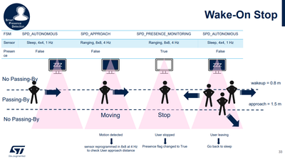

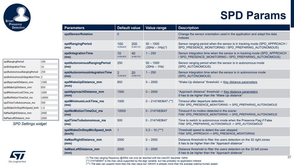

you can find a description of the params in the user guide, page 37.
It's important to understand that the approach state is active only if the user is above the WakeUpDistance.
Let me know if you can enter in approach state with these conditions.
Yann

In the SmartPresenceDetectionKit_F401_1.0.0 package, I found the Params_t structure defined in the sensor_command.h file. Are all of these parameters adjustable by the user to optimize detection behavior?
Or are there any parameters that should generally remain at their default values to ensure stable operation of the SPD algorithm?
I would appreciate your guidance on which parameters are safe or recommended to modify.

Technically, all the Params_t parameters are accessible by the user, but we recommend to adjust only the documented ones (see my previous message or the User Guide).
