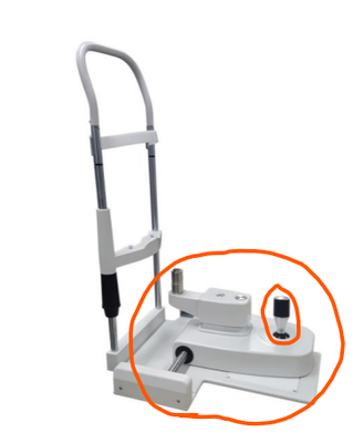

1. the base moves forward and laternal movements
2.sensor to track the movement of joystick (how miuch it is deviated from initial position )

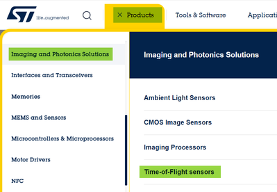

Can you please retry with this one :
Time-of-Flight sensors - Products (st.com)
If the link is not working you can find it here from the st.com page :
