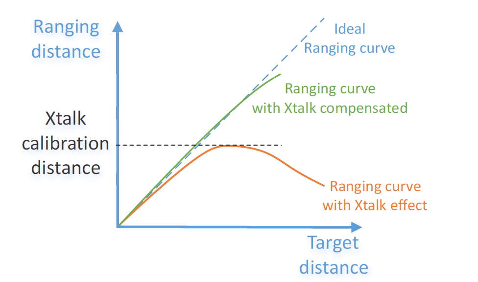

When you test VL53L1X with a cover glass on top of it, the cover glass will intrude xtalk, we need to do Xtalk calibration to compensate for the xtalk. see below picture, with cover glass sensor reported distance will be less than the real distance, the best calibration distance is the maximum ranging distance achievable reported by the sensor, or you can call it inflection point.
More detail information, please refer to UM2356.
