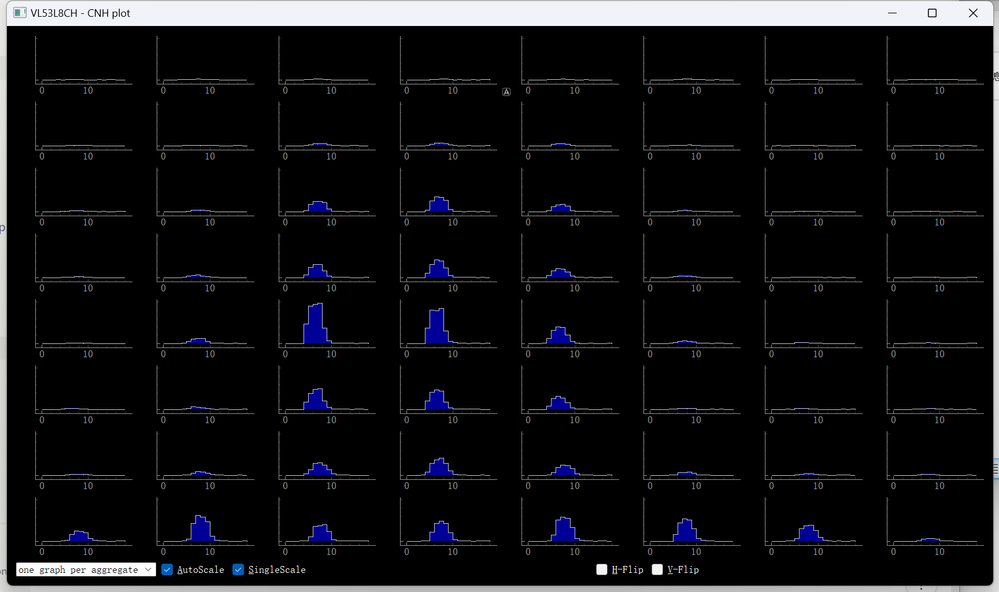

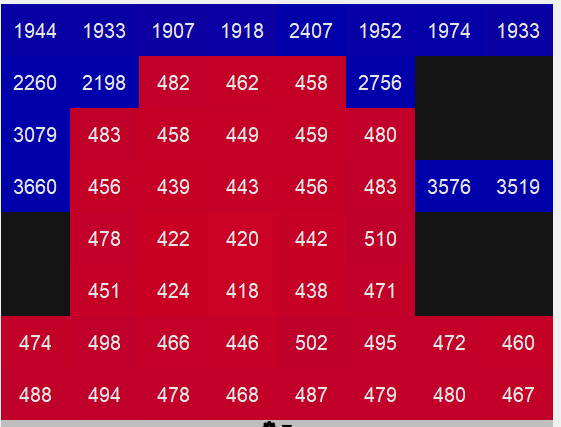

Besides, as shown in the figure is a ball, the depth difference of one pixel is less than 3.7mm. But as shown in the histogram, the depth difference is more than 15mm. I would like to know if this is caused by noise or some other reasons?
RogerM
Sorry, I am not entirely sure what is expected in the screen shots.
But I can make a few general comments.
The basic histogram bin width in terms of difference-of-target-range-per-bin is about 37mm per bin.  So it is very hard to determine accurate ranges just by inspection of the histogram bins.
On the other hand the "target range" zone output from the sensor uses quite sophisticated algorithms to extract target ranges from the histogram data -- so I would expect these to always give more accurate ranges.
On the the topic of "noise" in the histogram. The noise we see is just in amplitude, primarily caused by ambient light. We don't see any noise in the time / range dimension, i.e. no significant jitter in timing from frame to frame.
