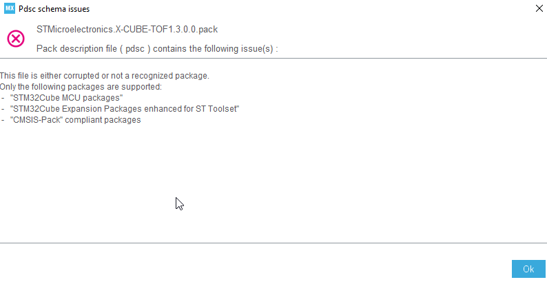

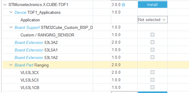

2022-06-15 12:03 AM
I can't select any of the support options in cubeMx ?
Where can we get some support for this?
Monday and Thuesday we are at Embedded
World, maybe an STM32 support engineer can help us out?
Thank you
