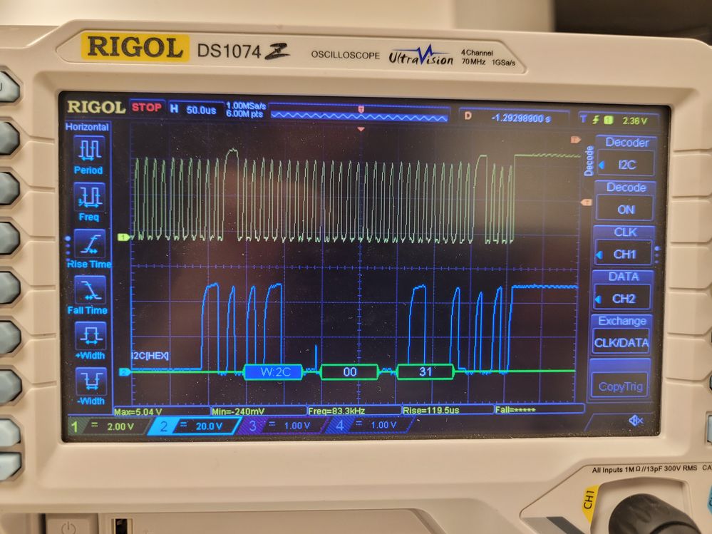

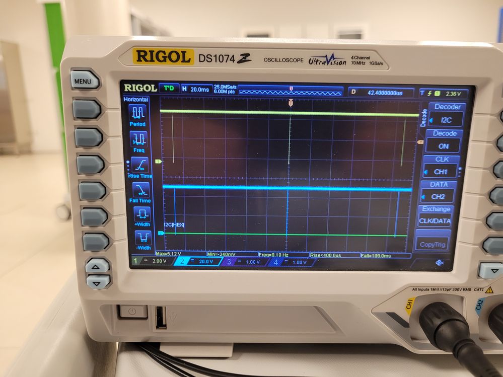

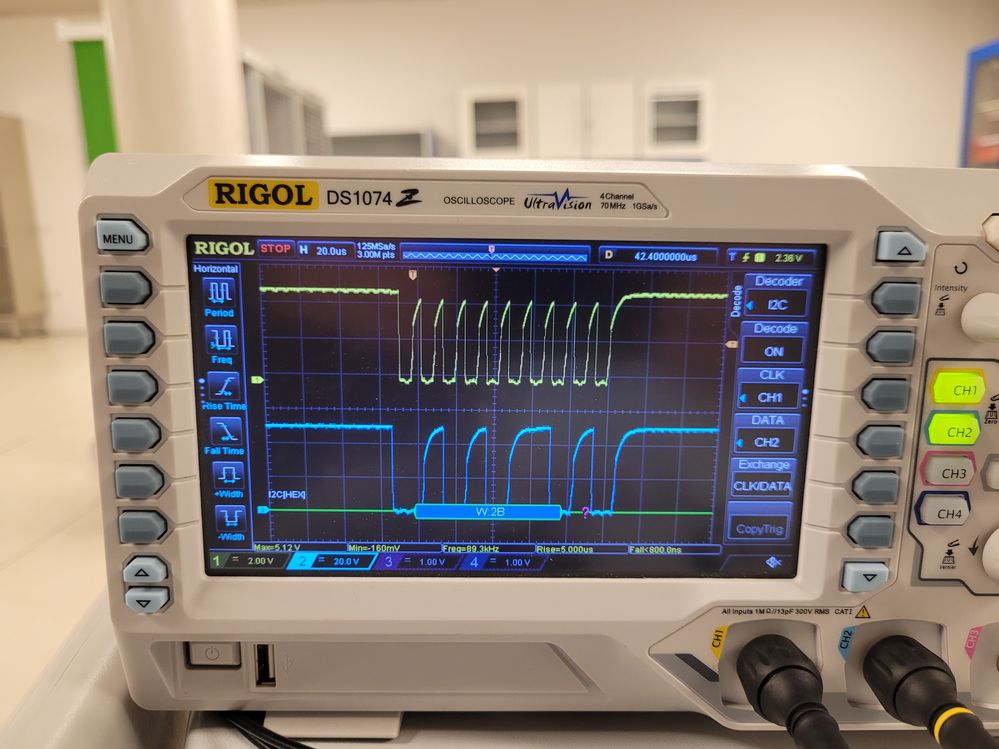

After analyzing the CLK and DATA line before the crash I've noticed that the STM32F091 I'm using is trying to reset the CLK line sending 9 pulses but the clock won't restart as intended.
The CLK and DATA line just before the crash.
Both lines when the I2C crashed and won't recover
On the board of the VL53L1X, we're using an SBLC6-2SC6 to suppress noise and a PCA9507D to convert the 5V level of the line to the 3V level of the VL53L1X. Pull-up resistors are 2.7kOhm and the GND of the VL53L1X has the two capacitators described in the datasheet 4,7uF and 100nF. We even have put BAV99 diodes on the XSHUT line.
The strange part is why the CLK line won't recover
