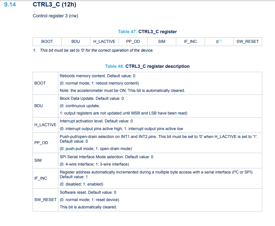

So... it just started working. I'm not sure what I did but I have a feeling that I might have put a bad value or somthing into a reserved reg. It might have had somthing todo with a bad value being put into bit 7. From what I can tell instead of reading form the reg and then updating what was read I sent a bunch of new values by mistake to CTRL3_C which might have triggerd BOOT and I asume wiped the device to a state where it started working again. I think I need to be more carful where I put my bits and bytes... haha.
One final question before I close this topic, whats the diffrence between BOOT and SW_RESET? Is SW_RESET todo with the FSM and MLC? Prehaps I should be reseting BOOT instead of SW_RESET to wipe the device config?

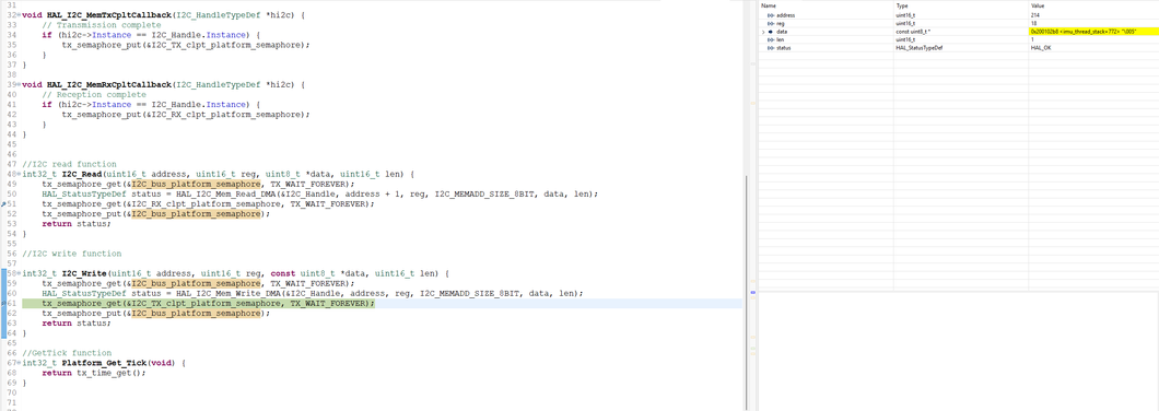

Good day @Karl Yamashita,
HAL is fine, as far as I can tell it transmits fine since I can write to other regs. Not sure if the bellow image will be readable.
I'm thinking the same thing about it reseting before acking but I would be surprised since thats not how the mag sensor behaves. Does I2C in blocking mode wait for an ACK? I would asume it does, in that case things are even stranger because using I2C in blocking without DMA still returns HAL_OK and as far as I can tell resets the device.
