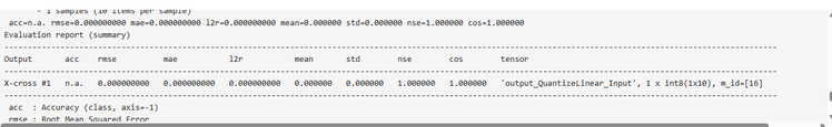

Could you run a validate on target to see if you get a good COS, example:
In the process of using AI on a MCU you can lose accuracy at multiple steps:
By looking at the cos with the model running on target, we can first see if this seems to come from your model or from your code.
