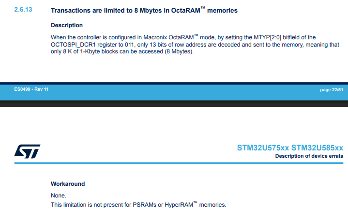

For context, since my last post & your response I have been able to get one of the smaller memory-footprint models working. Your advice was very helpful in this, as it was ultimately a timing issue with memory-mapped access, as far as I can tell. The 1.5MB activations-size model is working now, but I have another much more RAM-intensive model that is going to run on the same device. I have found STM32U575xx / STM32U585xx device errata 2.6.13 (screenshot below) which I believe may be my issue, as the model I am working with now has an activations buffer in the rang of 10-13MB, depending on optimization level.
I had initially written this off as my device is a PSRAM and the errata states that the limitation of 8MB transfer size does not apply to PSRAMs and HyperRAMs. This is especially confusing because to my knowledge PSRAMs very often use the Macronix RAM ordering, so I would expect the exception for PSRAMs to be more explicit about the differentiation. That said, there may be a piece of information I am missing here, and I am far from an expert on PSRAMs or memory devices in general. Regardless, after improving my OCTOSPI performance significantly, I have been able to get memory-mapped bursts and tight loops working properly, but have found 8MB is my new limitation.
Can you confirm that this errata would apply to the IS66WVO32M8DALL octal PSRAM?
It has 15 row address bits, which I believe confirms my suspicion more or less definitively, especially having found the same 8MB limit during testing, but again the wording of the errata is such that it isn't entirely clear. I believe I have a workaround on the X-CUBE-AI side of things (I plan to post on edge-AI forum in regards to that), but given all of the above I'd appreciate any further insight into this errata that you can provide.
