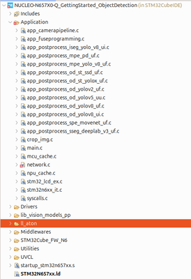

i convert my tflite of yolov8n without nms to neural-art related files in STM32N6 using stedgeai cli command as below
after that, i have to apply it to cubeISE which import NUCLEO-N657X0-Q object detection example.
i have a below question to be answered from you.
1. what is ll_aton? which looks like a runtime such as cuda runtime for nvidia gpu. any link for detailed?

1. The ll_aton library is related to the use of the NPU on the N6. So yes, I think your comparison is right.
You can find documentation about it here: https://stedgeai-dc.st.com/assets/embedded-docs/stneuralart_programming_model.html
