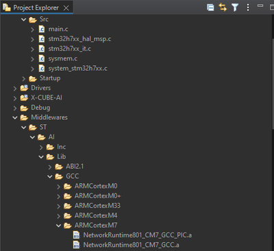

I've updated my code to CubeAI 8.1. The middleware is still deleted... but I can add it manually. However when I build the code I gett the error:
Description Resource Path Location Type
cannot find -l:NetworkRuntime730_CM7_GCC.a AI_FILES_GENERATOR C/C++ Problem
However, the file is there in Middlewares and the library paths have been generated. I have even added a library path to where this file is located and still it does not work.
I have created a new project with STM32CubeIDE with the latest CubeAI and the problem is still there.
Tool settings>Libraries
Error:
File in the project:
Thank you for any help
2023-07-20 6:33 AM - edited 2023-07-20 6:37 AM
The generated code is looking for a file called "NetworkRuntime730_CM7_GCC", but the middleware version is "NetworkRuntime801_CM7_GCC". This was why it could not be found. I am unsure how this happened, as this was with a new project.
As it was not working, I downgraded the version to 7.3.0 and copied over 8.0.1. This is why there is a discrepancy.
