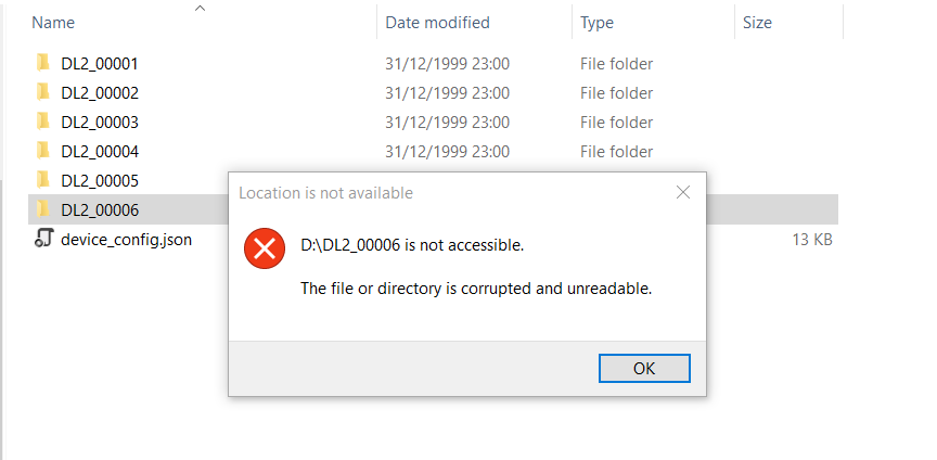

When I try to access the log files on the SD card on the computer, I get an error saying the directory is corrupt, so this probably shows that the software is crashing...
I cannot delete the folders, so I have to reformat the SD card.

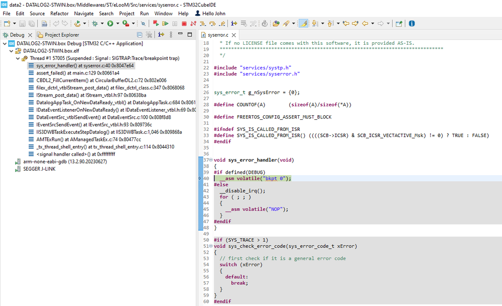

I have updated to v2.2.0 and the issue still exists
In this instance it went to a system handler....
