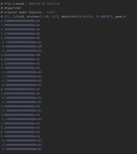

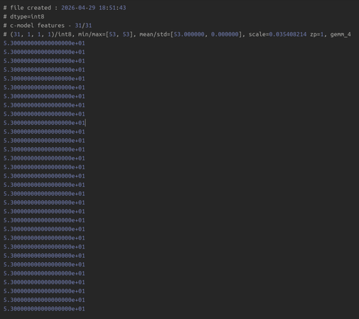

Yes when I tried the "validate on target" on AI Studio, I got the same output for every run, here's network_val_c_outputs.csv:
And here's network_val_m_outputs.csv:
Thank you very much for the help!

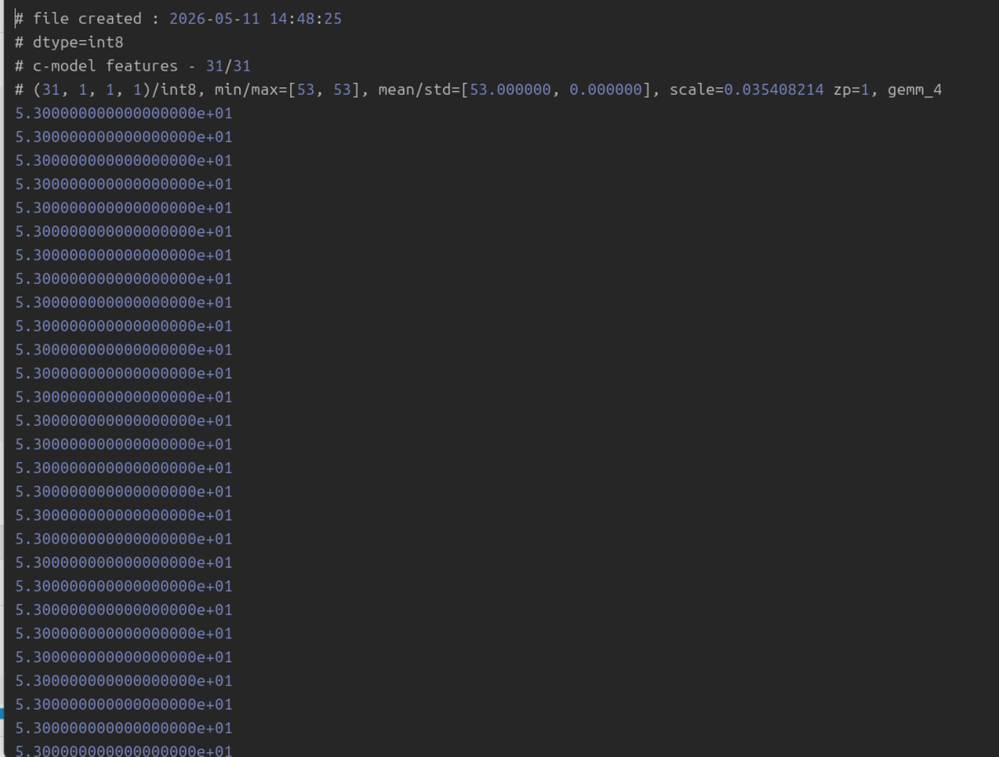

Hi @Julian E.
Thank you very much for your reply. I did two validations on targets, and without NPU looks good.
Here's the one with NPU:
outputoutputcoscos

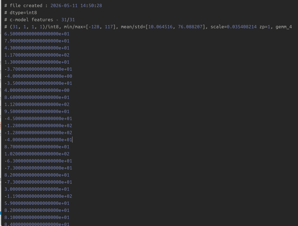

And here's the one without NPU, this looks normal:
