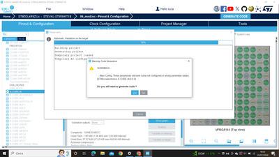

2024-07-25 10:12 AM
Good evening,
I tried to validate the project also with STM32CubeMX (last version) but I found the same error during the validation on target (as in photo).

2024-07-26 1:45 AM - edited 2024-07-26 1:47 AM
Your model requires 1.97MB of Flash and on this device there is 2MB available.
We consider that we need at least 30K for the program so you are probably just over the limit.
You have this message because during the analysis we report an error that the model won't fit on the target
Your model is a float model, using quantization you'll be able to make it fit on the target
By the way, on the developer cloud you can run your model on boards with more flash internally or externally
Regards
