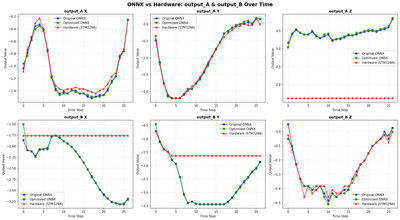

I'm trying to deploy a quantized ONNX neural network on a STM32N6-Nucleo and inference on board returns clipped values (see clipped-output.png).

Validation on target show a difference between onnx and hardware results. I've been further and I've run the original onnx model, the optimized onnx generated by "stedgeai generate" and the onboard model using stm_ai_runner on the same set of inputs. Results point out that values returned by the board are clipped.
I've suspected last int8-->float32 conversion layer added by --output-data-type float32 but it turns out that raw int8 are clipped as well.

Thanks for your answer. If this was the problem, shouldn't the issue arise when running the quantized onnx model ?
However, I've tried running the original float 32 onnx model on the board, performance are terrible but values are not clipped so there is definitely an issue with quantization.
