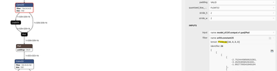

2. i get this error output!!
(yolov11) alientek@ubuntu:/opt/ST/STEdgeAI/2.2/Utilities/linux$ sudo ./stedgeai generate --model /home/alientek/best_saved_model/best_int8.tflite --target stm32mp25
[sudo] password for alientek:
ST Edge AI Core v2.2.0-20266 2adc00962
PASS: 0%| | 0/2 [00:00<?, ?it/s]E [ops/vsi_nn_op_conv2d.c:op_check:189]Inputs/Outputs data type not support: FLOAT16, SYMM PC INT8
E [vsi_nn_graph.c:setup_node:551]Check node[3] CONV2D fail
E [vnn_.c:vnn_Create:9463]CHECK STATUS(-1:A generic error code, used when no other describes the error.)
E [main.c:vnn_CreateNeuralNetwork:198]CHECK PTR 198
E [main.c:main:232]CHECK PTR 232
E 10:53:20 Fatal model generation error: 65280
E 10:53:20 ('Fatal model generation error: 65280', 'nbg_generate')
Error during first compilation.

2025-10-14 6:48 AM - edited 2025-10-14 6:51 AM
Hello @fanronghua0123456,
When you export the model, you get multiple ones.
It seems that this one: best_int8.tflite is not fully quantized.
In particular, the conv3 is not quantized:
explaining the error you get:
You need to use this one: yolo11n_integer_quant.tflite
This should work, but,by default, ultralytics exports the model quantized in per channel, which is not optimal for MP2. You will get an inference time of around 400ms.
║ X-LINUX-AI unified NN model benchmark ║
║ Machine ║ STM32MP257F-DK ║
║ CPU cores ║ 2 ║
║ CPU Clock frequency ║ 1.5GHz ║
║ GPU/NPU Driver Version ║ 6.4.21 ║
║ GPU/NPU Clock frequency ║ 800 MHZ ║
║ X-LINUX-AI Version ║ v6.1.1 ║
For hardware accelerated models, computation engine used for benchmark is NPU running at 800 MHZ
For other models, computation engine uses for benchmark is CPU with 2 cores at : 1.5GHz
║ NBG models benchmark ║
║ Model Name ║ Inference Time (ms) ║ CPU % ║ GPU % ║ NPU % ║ Peak RAM (MB) ║
║ yolo11n_integer_quant ║ 464.31 ║ 0.0 ║ 89.95 ║ 10.05 ║ 27.78 ║
║ Non-Optimal models ║
║ model name ║ comments ║
║ yolo11n_integer_quant ║ GPU usage is 89.95% compared to NPU usage 10.05% ║
║ ║ please verify if the model is quantized or that ║
║ ║ the quantization scheme used is the 8-bits per- ║
║ ║ tensor ║
Note: Peak RAM information is only APPROXIMATE to the actual memory footprint of the model at runtime.
Take the information at your discretion.
You can edit the code in ultralytics/ultralytics/engine/exporter.py to quantize the model in per tensor:
In def export_saved_model(self, prefix=colorstr("TensorFlow SavedModel:")):
keras_model = onnx2tf.convert(
1065 input_onnx_file_path=f_onnx,
1066 output_folder_path=str(f),
1067 not_use_onnxsim=True,
1068 verbosity="error", # note INT8-FP16 activation bug https://github.com/ultralytics/ultraly tics/issues/15873
1069 output_integer_quantized_tflite=self.args.int8,
1070 quant_type="per-tensor",
1071 custom_input_op_name_np_data_path=np_data,
1072 enable_batchmatmul_unfold=True and not self.args.int8, # fix lower no. of detected object s on GPU delegate
1073 output_signaturedefs=True, # fix error with Attention block group convolution
1074 disable_group_convolution=self.args.format in {"tfjs", "edgetpu"}, # fix error with group convolution
1075 )
The option 'quant_type="per-tensor"'
Which should give you this:
root@stm32mp2-e3-c3-c9:~# x-linux-ai-benchmark -m yolo11n_integer_quant_pt.nb
║ CPU cores ║ 2 ║
║ yolo11n_integer_quant_pt ║ 109.95 ║ 0.0 ║ 14.19 ║ 85.81 ║ 26.48 ║
So going from 400ms to 109ms because the NPU usage goes from 10% to 80% (due to per tensor quantization).
Have a good day,
Julian
