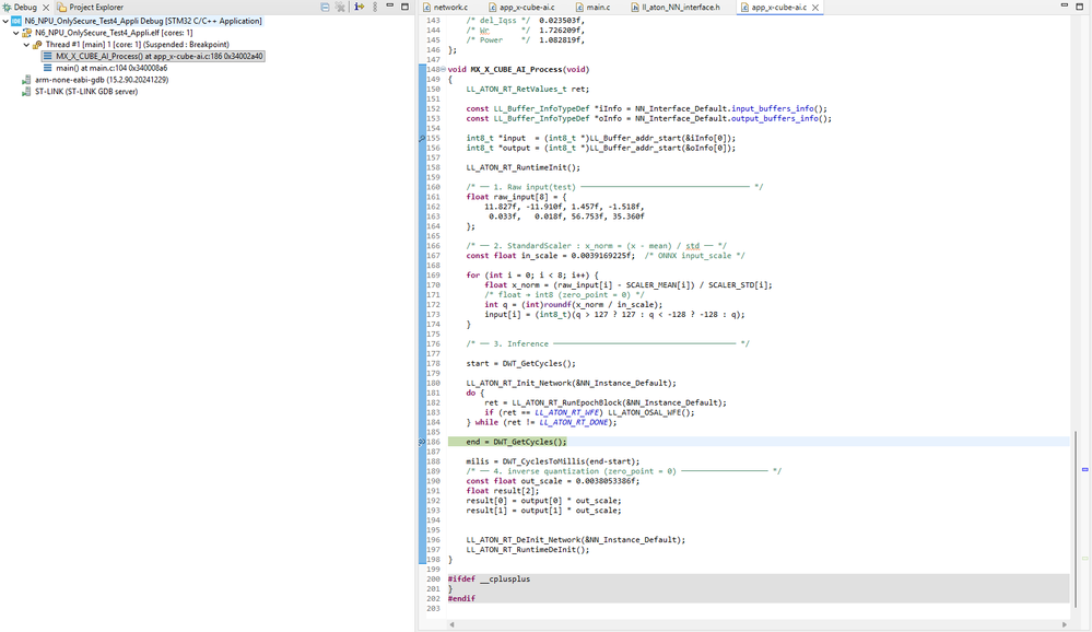

I am currently experiencing difficulties using the STM32N6 NUCLEO board.
My goal is to test NPU execution using X-CUBE-AI within CubeMX. However, I am stuck in an infinite loop inside the MX_X_CUBE_AI_Process function. Specifically, LL_ATON_RT_RunEpochBlock() continuously returns only the LL_ATON_RT_DONE status, preventing the loop from terminating as expected.
do {
ret = LL_ATON_RT_RunEpochBlock(&NN_Instance_Default);
if (ret == LL_ATON_RT_WFE) LL_ATON_OSAL_WFE();
} while (ret != LL_ATON_RT_DONE);
I Can't get the LL_ATON_RT_DONE, only LL_ATON_RT_WFE.
This issue persists even when using files generated via Cube AI Studio.
I have configured the AXI and Clock settings in CubeMX (CPU: 600MHz, NPU: 800MHz, AXI: 800MHz). Since the model is simple, I am using internal memory only and have not enabled any security (TrustZone) or external memory settings.

2026-03-31 10:38 PM
I’ve discovered a new issue with the test code I posted in my previous question.
To verify the NPU operation, I modified the input values and checked for corresponding changes in the output. However, I noticed that the output values remain unchanged regardless of the input.
I would like to know if I have misconfigured the AI Process structure or if there is an error elsewhere in my setup.
I feel like I'm missing something small, yet I'm still stuck. It’s a bit frustrating.

2026-05-15 3:53 AM
Thanks for your interest in this thread, even though it's been a while.
The issue was actually due to a common oversight: I missed calling SCB_CleanInvalidateDCache(); after memcpy.
By the way, the hardware I'm using is a Nucleo board.

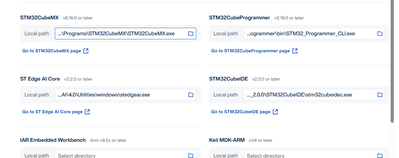

Here are the versions am using,
C:\ST\STM32CubeIDE_2.0.0\STM32CubeIDE\stm32cubeidec.exe
C:\ST\STEdgeAI\4.0\Utilities\windows
C:\Program Files\STMicroelectronics\STM32Cube\STM32CubeProgrammer\bin -> 2.22.0
C:\Users\jorda\AppData\Local\Programs\STM32CubeMX -> 6.17.0
2026-05-26 1:02 AM
Hello @Kamurasi-Jordan-Arthur
I was able to reproduce the exact same issue you're facing by testing one of the common mistakes often made.
On the STM32N6, the boot process behaves differently depending on the state of the BOOT1 pin. Please take a look at the link below for reference: :link: https://community.st.com/t5/stm32-mcus/stm32n6-boot-rom-explained/ta-p/763648
You need to configure the boot pins to Development Mode before running Cube AI Studio for it to work properly. As for flashing and saving the program, I highly recommend checking out several posts written by ST employees in the knowledge base link below: :link: https://community.st.com/t5/stm32-mcus/tkb-p/stm32-mcus-knowledge-base/label-name/stm32n6%20series
