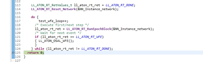

Execution gets stuck in:
do {
ll_aton_rt_ret = LL_ATON_RT_RunEpochBlock(&NN_Instance_network);
if (ll_aton_rt_ret == LL_ATON_RT_WFE)
LL_ATON_OSAL_WFE();
} while (ll_aton_rt_ret != LL_ATON_RT_DONE);
Observed behavior:
  • ll_aton_rt_ret remains LL_ATON_RT_WFE
  • Loop never exits

On my side, your project is not stuck in the while loop:
I will share with you a NUCLEO-N657X0-Q project with outputs in UART, if it works on your side, I will try to help you to modify the model integrated in it.

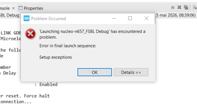

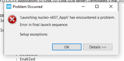

Im sorry but it doesnt work , when i try to debug the application i get this error
and when i try to debug the fsbl it doesnt get to the application , was i supposed to flash it manually beforehand or anyhting else ?

Yes, startup is quite tricky.
Either you start using this tutorial: How to debug STM32N6 using STM32CubeIDE - STMicroelectronics Community
Or, you can avoid signing procedure by:
- Flash Appli.elf with STM32CubeProg
- Power cycle your board
- Start your debug session with FSBL, and "Download" only the FSBL .elf file.
Best regards,
Yanis

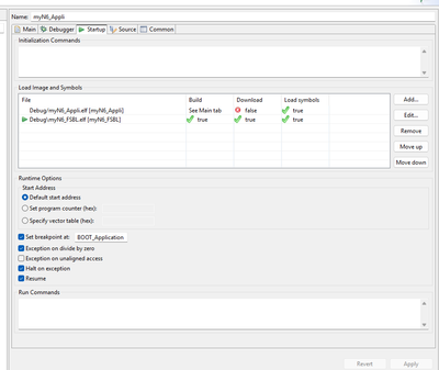

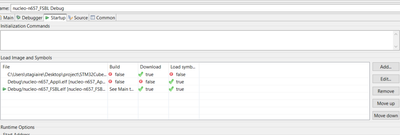

i did actually end up following the tutorial ( which i did in my intiial project too )
this is the configuration :
i ended up with the same error on the fsbl debug too !
I figured it might be a board problem , but its not as old project debug normally .
hamitiya
Could you please try to disable the first "binary" flash and only load the FSBL to see what happens?
You have two kinds of errors:
- ST-Link probe undetected => power-cycle required
- Startup issue => related to flashing procedure
Be aware that setting up breakpoints prior to jump to Application can lead to startup issues as well.
