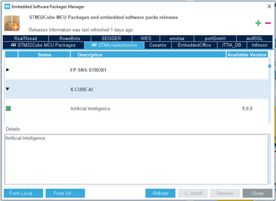

Once both install, we need to install the package X-Cube-AI in cubeMX:

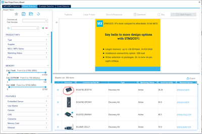

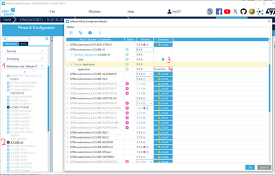

Then, we need to create a fake project, just to finish the install:
You should have a download of EdgeAI starting. It is what we wanted to get.
