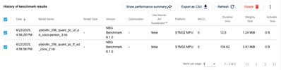

However, I’ve noticed a significant performance gap between my converted model and the pre-optimized model provided by ST, in terms of inference speed under the same environment.
Am I missing any optimization steps during the export process?
Are there any recommended configurations or parameters to match the official model’s performance?
Thank you for your support.

I conducted a performance comparison between the YOLOv8n model provided by ST and a model I converted myself using the official Ultralytics pre-trained YOLOv8n, with a focus on inference latency evaluation.
No retraining or modification was performed — I used the standard Ultralytics YOLOv8n model as-is.
The model was quantized and evaluated following the official ST tutorial:
The evaluation was performed on the STM32MP257F-EV1 platform:
