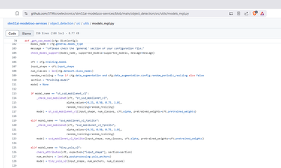

Regarding the pretraining of the tiny yolov2 I tried to use the option but it fails with "unrecognized option" message. As I see in the source code, the pretrained_weights are not expected.
