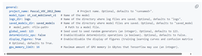

I suggest that, for any model, you start from the yaml in the model folder. In your case, this for example:
In the yaml, you can see what seems to be available or not.
