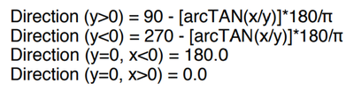

I then exported the data and used the following formula to calculate the heading...

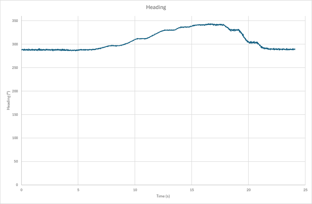

The result shows a heading between 285 degrees to 344 degrees (instead of a full 360 degree swing)...

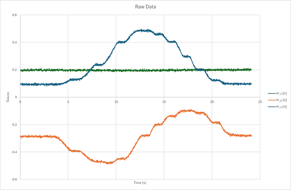

The raw data looks like this...
Spreadsheet iis2mdc.xlsx is attached for reference.
