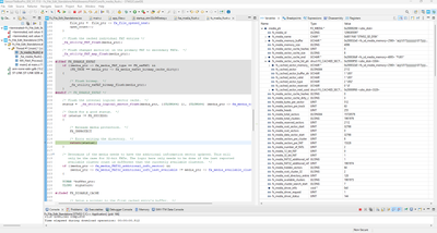

Here the Errror_Handler(); is invoked, and from the debugger i get these statues with status code = 144,
There was once it could successfully write the text file onto the sd card
but again that was once and even that time the fx_media_flush() error occurred.
I wanted to know how can i get around this error, and reliably read write delete files into sd card for a datalogger project.
