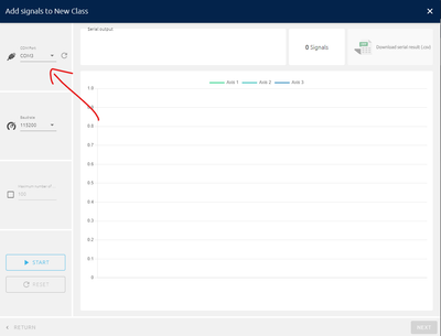

I've been stuck at this now for some time. I created a datalogger using the tool in NEAI studio, got a .zip file containing the Metadata.json and the neai_logger.bin. The .bin i flashed to the BOXPRO and i get a output using a STLink like the DL tool suggested.
When i try then try (Anomaly Detection) Add Signal -> Log Signal from Serial USB and connect to the port that worked in Putty/TeraTerm, i get a warning "No data detected, please check COM-Port and try again"

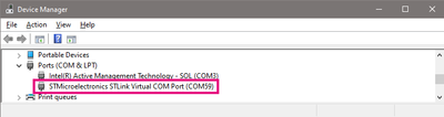

Hello @ThomasMSchmid,
I think you did not select the right COM port when logging.
You can see which come port you are using doing this:
Let me know if it worked,
Have a good day,
Julian

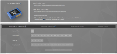

2025-06-17 8:44 AM
The STLink would show up as COM5.
Using cont-mode, i was able to to get the data in NEAI but it overwhelmed the system. But not with a datalogger @ODR:30, 256 Samples and Range: 8g.
To get the correct Signal format for Anomaly detection (i.e. 256 samples in N-lines), can i use the datalogger or would i have to format it myself?
2025-06-18 12:21 AM - edited 2025-06-18 12:21 AM
Indeed, the data logger in NanoEdge is made to get buffers as continuous mode is too fast to be logged here.
Please either use putty/tera term to log continuous data and it as .csv to import them in NanoEdge. Or log in NanoEdge but with buffer datalogger.
Have a good day,
Julian
