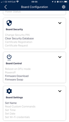

I am using the STEVAL-STWINBX1 development board and have downloaded the FP-SNS-DATALOG2 software.

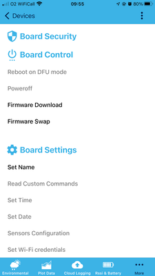

I am trying to get the WiFi working using the ST BLE Sensor apps, but the option 'Set Wi-Fi credentials' is greyed out.
I have even tried the classic app...
I have also tried it with the default firmware BLEDfFw, but again the 'Set Wi-Fi credentials' is greyed out.

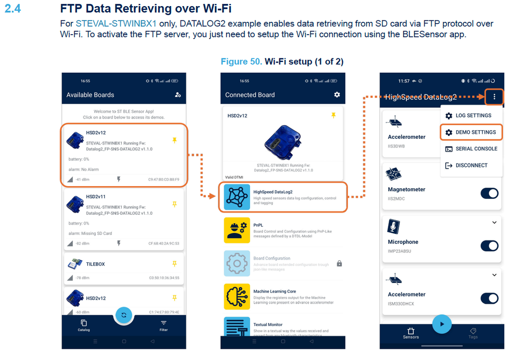

The user guide shows to click on the 3 dots in the right corner of the app....
But in my app, there are no 3 dots in the top right corner...
How do I get the WiFi connection working with this board ?

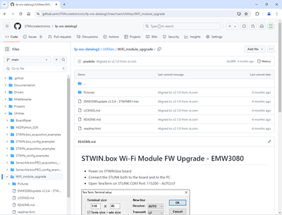

In case of Wi-Fi issues, the package provides also a ready-to-use procedure to check and upgrade the Wi-Fi module. You can find it in Utilites\WiFi_module_upgrade folder.
First I suggest you to do this procedure and upgrade the Wi-Fi module. Then, reinstall DATALOG2 firmware and restart it.

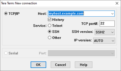

I did see the wifi firmware update and tried to perform it, but Tera Term does not have the option to select the serial port (its greyed out)...
The board is connected to the computer via USB and I have also tried DFU mode.
The readme document says to connect with STLINK, but I only have the Segger J-Link.
Does this mean its not possible to up date the wifi module without STLINK ?

Only ST-LINK products exposes also the serial via UART. Segger J-Link can only make you flash and debug the STM32, but no UART is available.
The UART is used as I/O communication: it is strictly necessary to upgrade the Wi-Fi module and send commands from a terminal to the module.
STEVAL-STWINBX1 kit contains an adapter to let the board compatible with any ST-LINK product from ST. ST-LINK is also available on any NUCLEO board from ST.
