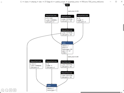

Julian E.
Hello @SR1218,
Your model is already very small. When quantizing the model in QDQ format (which is what we support, and the dev cloud is doing), it adds new layers quantize and dequatize that can help reducing the size of big models.
But in the case of small models, the weight of these multiples new layers increases more the size of the model than what you gain in terms of weights compression.
Non quantize model 53kb -> QDQ model 62kb.
In your case it even creates a bug when using the ST Edge AI Core (that converts the model to C, behing the dev cloud and X Cube AI). But as I explained, even if there was no bug, it would still not help you...
As you pointed out, the main issue here is the memory available on the STM32F401RE NUCLEO.
I don't know what your use case is, I would guess that it is related to sound based on your I/O.
For sound, our example applications are based on the B-U585I-IOT02A, and STM32N6570-DK, you may try to get one of these. (N6 is interesting for big models)
I don't see how you could reduce the size of your model to make it usable.
I can maybe advise you to take a look at NanoEdge AI Studio and see if the machine learning libraries (models) that it generates can be enough for your usecase. It is a free tool and very easy to use. If you have dataset, I think you can very quickly see if you seem to get good results or not
NanoEdge AI Studio - STMicroelectronics - STM32 AI
Have a good day,
Julian
