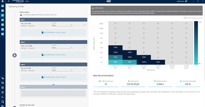

Frequency used:
The frequency used while collecting data also has a big impact on the results.
To help you find a starting point, you can take a look at the sampling finder.
You need to import "continuous data", here meaning 6 points per rows, at the maximum frequency to test combination of buffers size and subsampling to give you estimation of project results using these configurations.
Sampling finder documentation: https://wiki.st.com/stm32mcu/wiki/AI:NanoEdge_AI_Studio#Sampling_finder

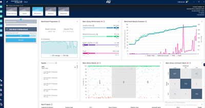

When doing tests in NanoEdge and running multiple benchmark, to gain time, you are not forced to run complete benchmarks that can take hours. In general, a benchmark converges in ~10-20 mins to an accuracy that is close that what you will ultimately get. The whole benchmark is really to optimize as much as possible the library. Which is to be done once, when you found the right parameters.
I would also encourage you to test the libraries in the Validation step.
After preprocessing your data, shuffle them (as data captured at the beginning/end of a session can be different, if you machine heat for example) and slit them into a train (80% of your data) and test set.
By default, NanoEdge is doing cross validation to get robust libraries, but, by testing multiples libraries, you could avoid overfitted libraries for example.
Lastly, if you see that you seem to have situation where the library works not so much as expected, try to log more of these situations and add the data to run new benchmarks. In your case, you are also probably mounting/ dismantling your drill to change from drilling or screwing. Each time, it may create slight difference in your data, so logging multiple time after mounting/ dismantling can help acquiring more variate data.

Using the Sampling Finder interface, I was recommended to collect data at 250 Hz sampling rate with a buffer size of 16 — which I implemented exactly like this in my code:

Hello @burak_Guzeller,
Concerning the behavior you observe in NanoEdge, it is because you provide files without enough data to do all the tests in the matrix.
As you can see, it will test multiple combination of buffer size and downsampling.
With 189 lines, it cannot test all the tests in grey.

My follow-up question is about dataset balance.
In my current project, I noticed that the Idle class can be more ambiguous than Drill or Screw, because it sometimes involves slight movements that may look similar to other classes.
Would it be acceptable in NanoEdge AI to collect a larger number of signals for Idle (for example, 500 signals) while having fewer but equal signals for Drill and Screw (for example, 50 each)?
The reason I’m asking is that Drill and Screw produce much more distinct vibration patterns, so I believe they may not require as many examples as Idle, which has more subtle variations.
Or is it mandatory to keep the number of signals per class strictly balanced?
@burak_Guzeller
It is recommended to have a balanced dataset.
but again, only doing tests will give you an answer.
You can try to have more data of the classes that do not give good results.
Have a good day,
Julian
