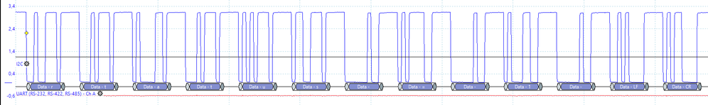

}I use VL53LX_RdByte() according to the STM32F401RE example because I know which value must be returned. However, the nrf returns a NACK after VL53LX_RdByte(). So I checked the status value returned from the function WaitDeviceBooted(Dev), and it seems the function return 1 :
Confirmed by frame analysis :
How is that possible? I see in vl53lx_error_codes.h that there is no error code equal to 1. All error codes are signed interger, and negative numbers. Power supply around 3V (battery) and is fine. XSHUT in is directly wired to VDD because I don't want to handle hardware standby mode. Is there something I miss? Thank you for your help!
