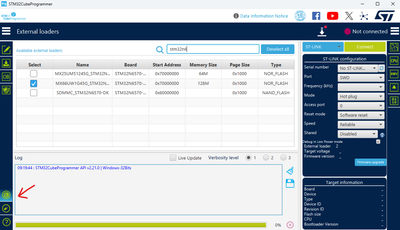

2026-02-17 8:30 PM
I get the core is locked up in stm32cubeprogrammer while flashing the files. I connected camera correctly.
