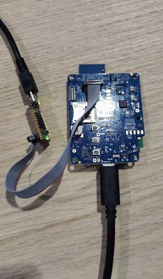

2025-03-10 2:00 AM - edited 2025-03-10 2:02 AM
Hello @Mahdouch ,
You need both a ST Link to flash the firmware and to connect the board via USB C to send data.
You need to make sure to have data cable in both cases.
If you forgot to use the second cable, the COM port that you were using is probably the one from the ST Link, so don't forget to change it in the emulator.
Can you test to retrieve data in the "SIGNAL STEP" via serial. The behavior should be the same.

2025-03-13 2:10 PM - edited 2025-03-13 2:12 PM
Hello @Julian E.E.,
I’m using both cables as you suggested, one for the ST-Link to flash the firmware and the other for power supply and data communication via USB-C. However, NanoEdge AI is not detecting anything from the board. I’ve double-checked the connections, and the COM port is correctly set, but I’m still facing the issue, i don't receive no data in Signals nor in Model Training, (I got my signals from the dataloger2 successfully). Could you suggest anything else I might be missing?

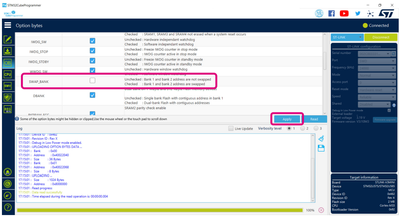

2025-03-14 1:50 AM
Hello @Mahdouch
While waiting for the feedback from the expert, let me suggest you a further check on your setup.
STEVAL-STWINBX1 is based on STM32U5, a double-bank flash microcontroller. By default, the firmware is flashed onto the first bank. Instead, after the execution of a firmware update via FOTA using the BLESensor app or by using specific commands while running DATALOG2 firmware, it’s possible to change the running flash bank.
Maybe you did it by mistake and, if this is your case, you flashed the NanoEdge AI datalogger onto the bank 2, but still trying executing firmware from bank 1.
To overcome this issue, FP-SNS-DATALOG2 contains the script called reset_and_program.bat that resets the board. It’s available in the folder Utilities\BoardReset\STWIN.box.
In alternative, you can use STM32CubeProgrammer, the option bytes section > User configuration and check SWAP_BANK. It must be unchecked.
The full procedure is also available in the FP-SNS-DATALOG2 User Manual (chapter 2.1.4 How to handle double bank flash memory) and Quick Start Guide.
Try running it, and then flash the NanoEdge AI datalogger.
I wish this can help you.
Best regards,
Simone

2025-03-14 4:50 AM
I did as you said but stand still,
